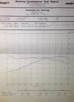

So, the results are in:
RESULTS: Gain of about 5hp and 12tq, giving me
329hp and 338tq
at the wheels (Mustang Dyno)
baseline is 325hp, 326tq (unlike the "I gained 33hp/9tq" FX https://www.facebook.com/photo.php?....9935.110830775640729&type=1&relevant_count=1)
Modifications
K&N Drop-ins
HKS Replica Dual mufflers
Stock cats, Stock resonators.
The Tune:
Adjusted A/F
Removed Rev/Speed Limiter
Removed fuel cutout w/ braking (for "launching")
(Couldn't adjust Ignition timing)
True 100% WOT
ETC.
Right now I guess the car does drive better than it did before, feels peppier. Obvi I'm not going to feel 5hp/12tq but the driving is a bit different from adjusting the WOT, etc.
Dyno printout:
I'm going to try and get HFC or test pipes, maybe change the stock resonators too, then do a retune (may also try and do custom intakes w/ ducts)
then hopefully by then ignition timing adjustment will be available again… however…...
FYI UPREV IS SUSPENDING SUPPORT FOR THE INFINITI FX50 Until they can "figure out" the issue with the Ignition timing..:eek.:
So I guess everyone will have to wait a bit until they figure this out before tuning….
They "don't have" the correct files/tables for ignition timing tuning and therefore you cannot get a "full" tune with osiris…
also there is nO WAY to see KNOCK while tuning the FX50….another problem
I still recommend getting a dull custom tune, regardless of what happened to me today. Plus, if you have more mods it makes sense to get a 'real' tune… I barely have any mods, but after I add HFC / maybe custom intake (and hopefully after they figure out ignition tuning issue) I will be back in for a proper tune
