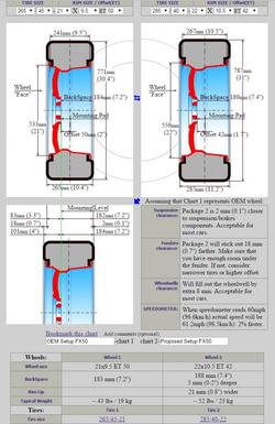

Seems like I am struggling with wheel sizing fitment issues, like several folks on here, when ordering wheels online. I am attempting to go to a 22" wheel, replacing my OEM 21x9.5" with +50mm offset wheels. I am trying to go a bit concave, clear the hub, avoid rubbing (especially in the front w/ a BBK on the FX50), push outboard somewhere between 20-25mm on all 4 corners, and go as wide as possible with a square stance. At this point, I have located some new wheels that come in a 22x10.5" variety with both a +42mm and +25mm offset. They also come in a 22x9" variety with similar offsets, but for the stance I am trying to achieve, I selected the 22x105" with +42mm offset. Here are my calculation results with a 285/40r22 and 295/35r22 setup, my questions follow:
Questions:
So my biggest concern is on the front-end where the BBK lives - can it be cleared with these wheels? Next, the hub stub ends - will I need to get a hubcap extension (prefer the flush cap)? Next, suspension components - is the 2-5mm calculated inboard difference likely to hit anything? Finally, I'd prefer the 295/35r22 tires - rubbing issues on the inner fender possible (I intend to drop with H&Rs down the road)? Thanks for the input in advance.

Shadow191 - I think the bigger issue is the offset for the fx50s. Clearly the wheel/tire combination on a 22x10.5 is an inch wider than the stock wheel and the tire size range typically runs between a 275 and a 295 (which is certainly bigger as well). I'm willing to accept those dimensions because I know it can fit - I just need to make sure I can clear the BBK with proper offset.
Fxmonkey - I hear you, and I like the staggered look, but the practical side of me prefers to be able to rotate the tires. However, it's quickly becoming problematic to find the right setup. The Vossens that Brian has for sale are actually pretty close to being ideal for the FX50 owners as it comes in a +30 offset (which results in almost 25mm outboard poke and clears everything mechanical). HINT HINT to any FX50 owners that like that CV1 look, those are a steal! I'm just not wild about those style vossens, no offense to Brian, and new vossens are way too overpriced. He actually gave me first shot at them.
The best I have been able to find in the square setup is a set of 22" x 10.5" with +40mm offset on 285/35r22s. With this setup I am looking at coming inboard about just under 3mm and the outboard poke is about 20mm - which is looking about spot-on for the tight tuck look. I am still somewhat concerned with the extra 3mm inboard stance on the offset as that is getting really close to the BBK in the front. On paper, it looks like it will just barely clear 'em. The OEM 21s clear the BBK by about 5mm. I am curious if any FX50 owner is running this same setup and can comment?
