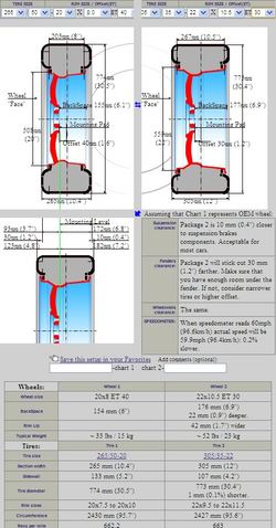

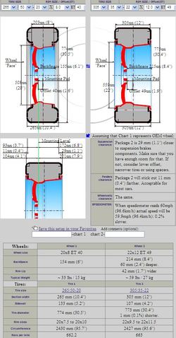

Here is what I'm leaning towards now. It looks like it should work using the calculator, but, can anyone take me to 100% it will work? :smile (2):
Option 6: the Aggressive Rookie, Deep Concave all around, maximum width in rear
22x10.5 Front +30mm offset on 305/35/22 tire (30.40 inch tire diameter, 42mm more than stock offset)
22x12 Rear +49mm offset on 305/35/22 tire (30.40 inch tire diameter, 42mm more than stock offset)
I am 90% sure the front fitment works (pushes even closer to strut).
I am 90% sure the rear fitment works (pushes closer in the fender).
I am more confident in this setup because it pushes it so far out, inner clearance for any suspension should be fine. But the 10% is again the fender rub.

far as fitment, I have an 11" with +48 offset. I'd say that at a standard dropped spring height with the stock suspension I could get another ~11mm towards the outside & ~15mm towards the inside as max, so that would equal a 12" wheel at what would equate to a +50, so your +49 is right there, should work out fine & be at max fitment... you will probably have to roll the inner lip of the quarter panel & trim the wheel opening molding but that's really no big deal...
That information is as good as gold to me. Just thought I'd point that out.
With that information, anyone should be able to estimate the right offset for any wheel setup.
