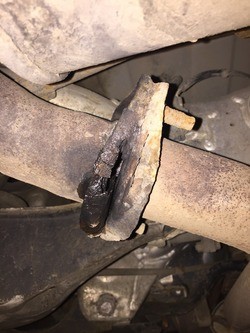

So that went wrong, new muffler and new pipe leading to muffler...OR cut it off and went straight pipe instead of flanges and done
