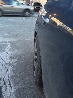

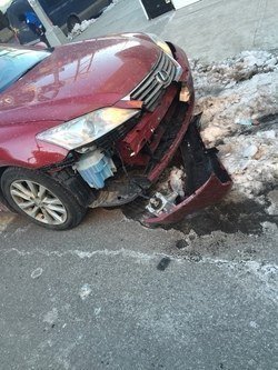

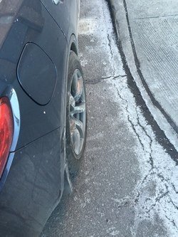

The f'd up part is he's a lawyer who hit my car trying to act stupid saying he didn't know what happened

9b4536fa942465b9bfc6397ae64be177.jpgd6353081ff851a55288ecff25da0f831.jpgd32019b90626a306eab64b0f7d1f5de6.jpg

WTF!!!!!! Is the whole supension jacked up or is it just the wheels and the alignment? If it the suspension make sure he pays for some lowered springs... jk Im glad your wife okay
