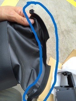

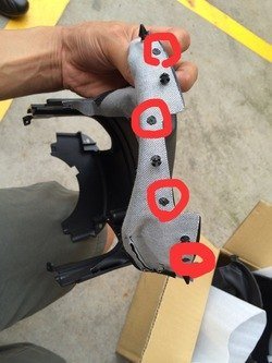

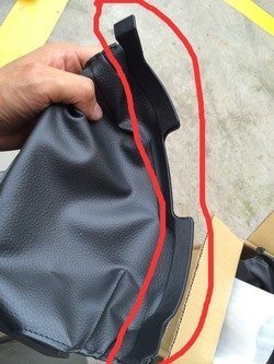

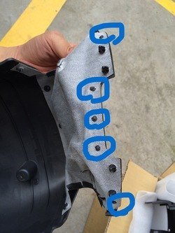

EX(QX50) can install steering cover of FX(QX70) for paddle shifter, steering cover part no. of FX is 48470-1CA2B or 48470-1CA2A
Lower steering Cover of FX is used on EX must do some change.
Red part is from FX, blue part is from EX!
Exchange red and bule parts
Before you exchange both of parts! Cutting off these points
