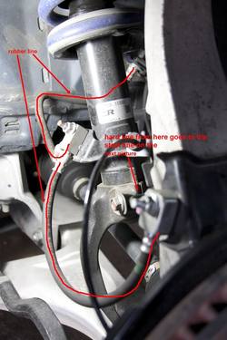

I tried to install a set of Akebono caliper onto Rip's ride using shortened banjo bolt Zebra made with the stock line. From the look of those Stoptech SS lines, you definitely need to shorten the banjo bolt to fit properly. Since we're on the topic, take a look of the stock brake of Rip's ride. This the front brake line of a 2013 FX37. I wonder why all the clunky joints on the rubber line. Looks like they use the joints as anchor to bolt it to the strut housing.
If using the the Stoptech SS lines, I guess you'll go from the hard line by the frame to the caliper and plug the both ends of the hard lines on the knuckle. I didn't look to see if the hard line can easily be removed with if not use.
