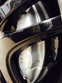

I recently upgraded my FX35 brakes with FX50's Akebono set with Stoptech sloted sport rotors.
I run Project Mu pads in the front and rear, and after 1 week of usage rear ones started to sqeak so bad So it became annoying, front ones are just fine.
Do you think this is a pads vs rotors issue or smth else? (low brake fluid pressure or etc)
I'm thinking to replace rear ones with Akebono pro act. Did anyones used Pro Acts with Stoptech Rotors? Are they quiet? Thanks for your advices

I also can't complaint on stoping power - it's great. But I'm furstrating why rear ones squeal even after 30 minutes of drive.
When I push pedal hard it is 100% quite, but when I do light rolling stops at stop sign it's just annoying.
I even can feel that sound comes from rear left side, asked my brother to assist me and we are both positive that left rear is the squeal generator. I'm so furstrated fronts are perfect and rear right is great as well, but left ... Agrhhhh!!
