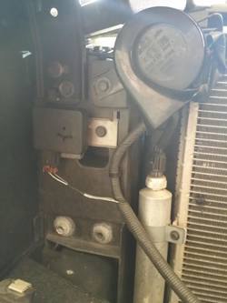

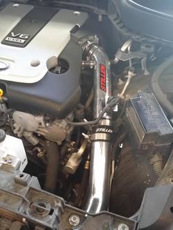

Just finished CAI mod to my FX37. Used a Stillen 3rd gen ultra long dual intake. Take a look at the pictures. I haven't seen any other posts on the forum with this mod yet. If you have any questions let me know.
Couple of things that had to be done to complete this.

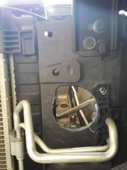

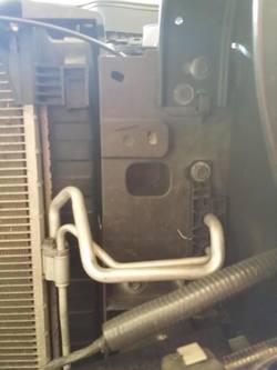

1. Had to relocate the black box on the passenger side because its original position is in the way of the CAI new hole.
2. Had to purchase 1.25'' by 1.25'' air duct foam to create a snug fit that looked fairly factory. You can see it in the photos
3. 370z intake has 2 input ports beside the main 2.5" that are the same size. The FX37 has 2 different size ports. Had to purchase a black hose with an ID of 7/8'' to connect this odd size change between engines.
4. Drill 2x holes through the radiator support to pipe the intake through.
Noticable difference in power. Nice sound now. Got it used from a 2010 370z off eBay. Took 2 hours to install start to finish.
