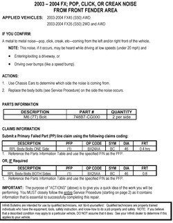

Could this be your problem:
TSB # ITB04-043a
If this is on record that you complained about a noise coming from front suspension....show this this TSB. If the noise was on record while under warranty, the Dealer should help you out....emphasis on should, cause not all will.

Just read that up above. Looks like that TSB is for a noise only when moving. If you're at a standstill, it might be my diagnosis.

Bring the TSB into another Infinti dealer. Bring the records from your NIssan dealer and state that this used to be an Infiniti dealer.

TSB # ITB04-043a
TSB # ITB04-043a
I can't seem to find this TSB in Infiniti help anymore. They seem to have moved the link in that site.:thumpdown:

I had the TSB fix done and it solved it, then it came back. It was actually my hood this time...
The TSB was done under warranty luckily, but I saw the bill and it was over $1,000 to fix if I paid out of pocket (they ended up replacing most of the suspension parts while trying to fix it -- no complaints here I got new struts out of it).
have same problem on my 03 FX35 , replace the 2 fender bolt but this did not help. replace inner and outer tie rod did not help , anyone know what wrong with it ?????? does a bad strut mount bearing makes the same noise on bumps ???????? pease help
