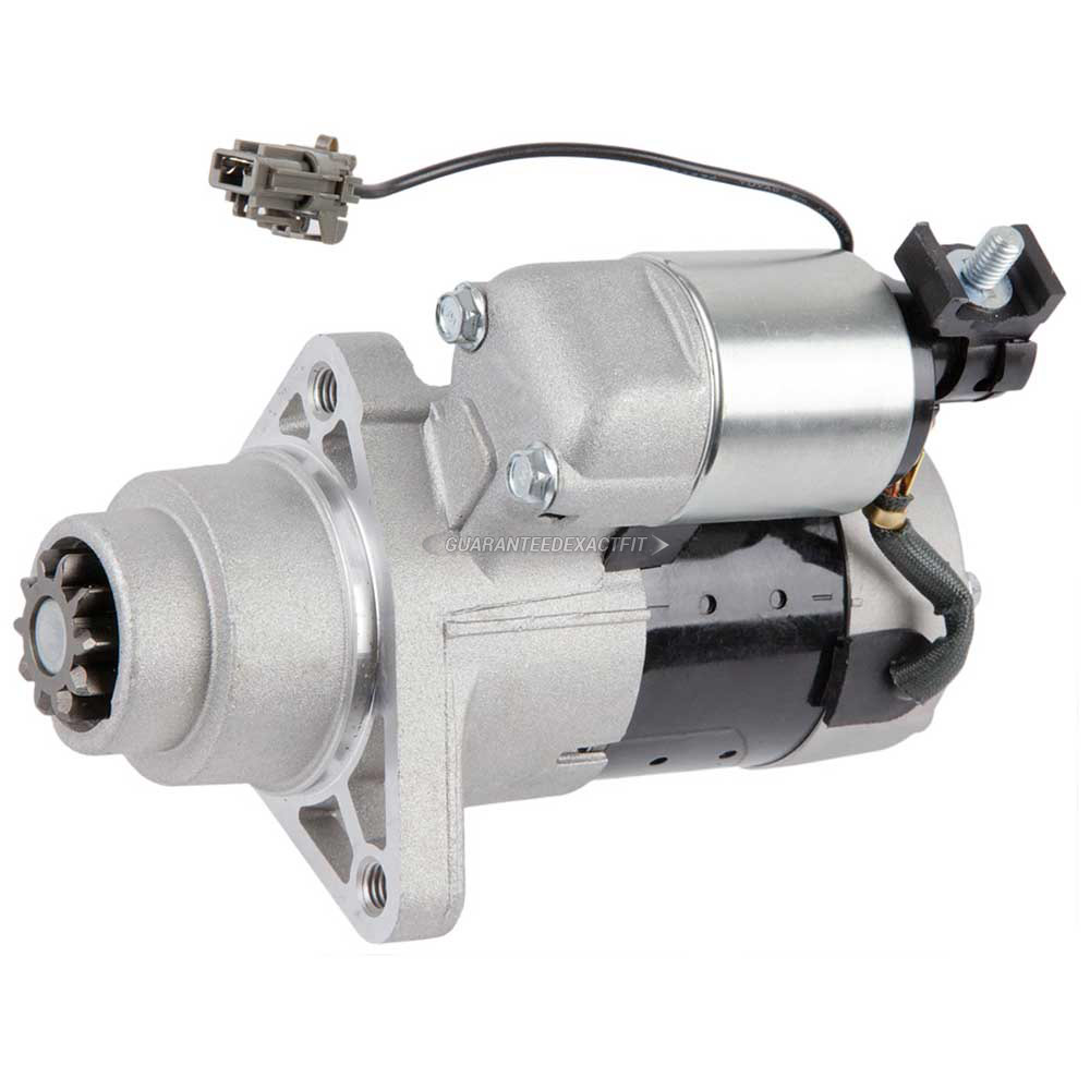

So here's what a starter looks like..yes we all know this guy...its a visual reference so I can explain...
That bump on the side of the starter..that's the relay/electromagnet...it is the guy that powers up, magnetically moves a lever inside the starter to push out the gear to make contact with the flywheel AAAAND...create a circuit to power the starter ONCE the gear has fully extended to reach the flywheel.. :)
That bump as I call it...see the two bolts...pop those babies off, take off that electromagnet/relay, pop the new one on and you're back in business!!

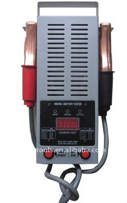

How did I avoid this from happening again...I bought a battery tester..no not a voltage meter but one of those testers that you can get for around $20-$40, you put the clamps on the battery and flip a switch that puts a big load on the battery and the dial or the digital screen shows you if the battery is still good or its on it's last legs...

Here's a photo of the battery tester...these are usually cheap and on sale but do the trick..or you can go to a more expensive solution or get your dealer/mechanic to throw on a professional one and get a better reading on it's status. Do this once a year, and save yourself from expensive tows and repair bills. Just make sure it's a battery tester that puts a load on the battery, that's what you need. Without a load, most batteries look flawless, that's just how it is.
