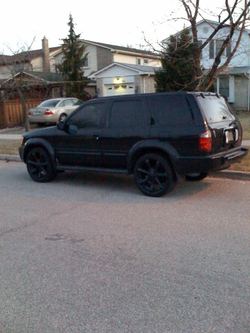

not the best pics but I traded into my FX shortly after I had them done.
the wheels were fine no shaking or any negative effects of any kind
