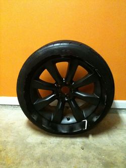

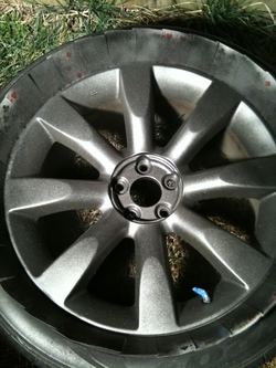

I have read up extensively all across the web about Plasti dip.
I decided today to try it out. waiting on the gloss black top coat to dry
I cleaned, sprayed 5 coats of black plasti dip
then 2 light coats of duplicolor metallic graphite then light coat of gloss black on top of the silver metallic

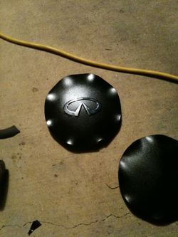

I tried this same set up on the center caps first. the silver metallic just looked too similiar to the stock wheels except it has the flakes/sparkle to it. so i tried the gloss black over it. It looked awesome so itried it on the wheels
I know Plasti dip isnt permanent but i wanted to see how i liked black wheels before i painted them.

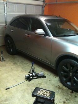

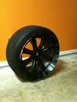

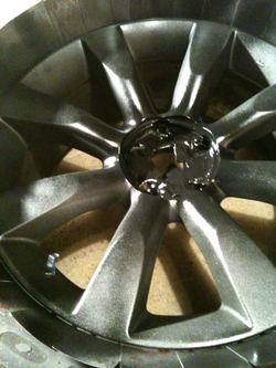

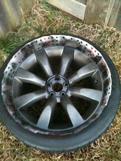

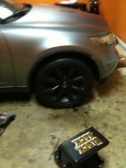

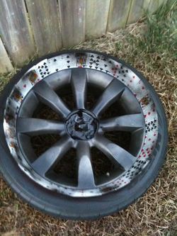

Looks good. I'm guessing the last two pics is the finished product and the other ones are in the drying process? (hence the miscolorations?)
yep you got it.
The card trick didnt work at all with 32+psi had to let all the air out to keep them in there
only did 2 wheels :) passenger side to see if i liked it or not so far i like it but we will see how it looks later

the silver coat has a lot of metallic flake and they show throught he light black top coat a bit
