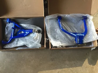

Megan released adjustable control arms for the 2nd gen a few months ago. I wasn't sure how much they would help our camber issue so decided to buy the fronts and rears to install with my coilovers. I was surprised to see the alignment sheet when I went to pick up the FX. Everything was within spec. I thought price was reasonable too. $570 for the rears and $314 for fronts. Here's a pic of the control arms.

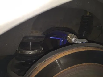

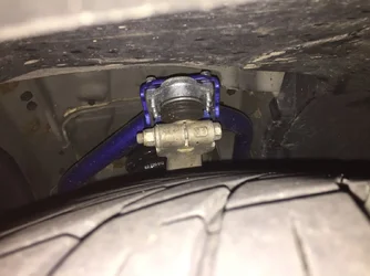

I went with BC coils. I'll try to take some pics of them installed and a pic of the alignment sheet later tonight.

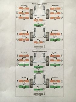

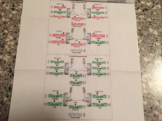

Yea, they have been out for a while. I was surprised no one had posted them. I've been driving around with them for a month now. No issues. Here's the alignment sheet.
Lol your alignment sheet makes me jealous. 052ed9b7c4a327de81eaab4d136e13a0.jpg
