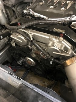

Some interesting things have been found - not good things, either.
First, the bellows in the flex pipe was cracked - we knew this. It's the reason the car went in the last two visits.
To compound this failure, the merge pipe failed as well. No wonder boost pressure dropped off!
The merge pipe has been repaired before AND we will be going to twin wastegates, so the collector is pretty much garbage. Fine with me since we are doing all new fab from the motor all the way to the turbo.
And then we found the CHRA leaking oil. This isn't necessarily a failure - there's nothing wrong with the turbo output or performance. But it will most likely continue to get worse so as long as everything else is out AND we are going to a twin-scroll GT series turbo, we might as well replace the CHRA.
Shot of the engine with the turbo removed; we will most likely come up with a new mount to try to limit the vibrations & loading going into the piping.
