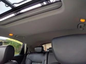

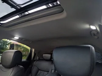

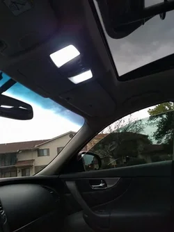

Wasnt difficult at all... had to go through the back of tailgate to get at the plate lights.
