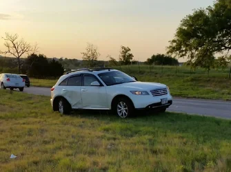

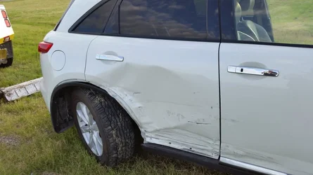

May not have to worry about this issue anymore. Got t-boned this morning by a red light runner with no license or insurance. Find out tomorrow if my insurance company decides to declare it a total loss....
Thanks, just a little sore. FX took the hit like a boss. Spun me around 3 times and ended up facing traffic on a 3 lane 55MPH highway. Was still able to limp it to a safe spot dragging the right rear wheel. Not sure how to post pictures on this site. When I figure it out, I'll post a couple.
Glad to hear youre OK since the FX can always be replaced. As for the pictures, if you have the pics saved locally on your computer/tablet/phone, you can click,on the upload a file button on the bottom right and do it that way.
