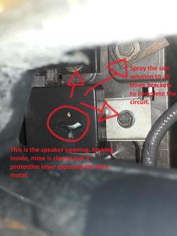

Did a test at home today and was able to recreate the issue. So you take a spray bottle, dump some salt into it, maybe about 3-4 tablespoons, can be any type of salt (I used road salt), pour some warm water about halfway, put the spray top on and shake the salt until it doesn't dissolve anymore, then top up the rest of the bottle with cool water.
Now its time to spray the buzzer/beeper on the front end. Facing the grill, spray the buzzer that is located on the upper left corner of the grill. It sits behind the grill, looks like a square black box with round slits in it which contain the metal buzzer dome. Using your salt and water solution, spray the buzzer inside the slits and create a circuit up to the mounting bracket it uses to complete the circuit. You will start to notice a sound coming out of it and as you spray more salt solution, it will become louder (higher conductivity of current due to the solution). This proves your speaker is defective. Mine is corroded and that's why it conducts.
This is how you will be able to make it sound for your appointment to get it replaced since you may not have the opportunity to get that sound going if your appointment is on a day where the roads are dry.
Here's a photo of the speaker box:

Thanks! I'm going to schedule an appointment this week and see what they come up with. I never had this issue in my first Gen so there's a flaw in the design of the newer units on the second Gen. I've seen this issue on 370zs as well. Same box on the front.
