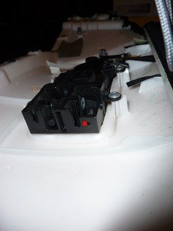

Here is the underside of the door panel.
Trace your actuator onto the stiff foam.
Cut the foam and fit the actuator in.
Fully cut this piece off to make room for the 3 screw mounting piece.
Also fully cut this bottom piece flat.
Drill a hole to run the metal connector (in the picture I had to lower the hole down to the red area to make it work). So drill the hole lower than the pic.
Measure the rod and mark it, you will need enough space to make the actuator go in and out.
Cut the rod after you are happy with the location.
Test fit everything, make sure the actuator is fully closed towards itself.
After I was happy with the fit I just used 2 zip ties to mount it firmly to the foam block.
