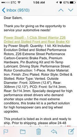

Working these days on having a TT on my fx35, did not receive it yet from Gamma but hopefully within couple of weeks. My target Horsepower on wheel is 550 and ll do some re-build to my engine mainly Pistons and RODs due to high milage ( 200k+). Long story short, am thinking of upgrading my braking system and am not sure either to do it or postpond it to later. One guy recommend to me power stop but am not that experts and dont know the good brands. I never heard about this brand. I know EBC, Akbeno ( the most I like but kinda over my budget for the time being), stop tech, etc..

with twin turbos and 550whp i dont think your stock brakes will cut it. I say look into the FX50 bbk or a aftermarket BBK. And before you do your brakes you probably need a tranny upgrade...
Upgrading rotors and pads are not enough for twin turbo with 550whp. At the very least, you need the FX50 OEM Akebono brakes, which have 4 pistons in the front (comparing to the stock FX35 2 pistons). Some have gone up to aftermarket 6 or to even 8 pistons. Eight pistons are excessive, but that's just me.

Just my opinion, but I don't think that just because you upgrade the engine hp, you automatically need to upgrade the brakes. The physics don't change - stopping from 80mph or 120mph is the same with or without a turbo - you just get to that speed quicker. If you plan on driving more aggressively all the time, sure you'll need better brakes, but that's not a function of more power necessarily.
Upgrading just the rotors is also pointless as well, your braking performance isn't going to change. Pads matter, tires matter, rotors don't matter much at all. It would be much better to save up for an actual big brake kit. Whether that is FX50 or aftermarket depends on your budget. More pistons doesn't mean anything; what matters is how much surface area there is on the pistons, that is what applies clamping force to the pads. More pistons is really just marketing and it may help with pad engagement and brake feel. Note that the reputable high end brake companies don't usually go past 6 much, sometimes 8. But the "show" companies offer 8,10, even 12. You can have 2 piston brakes outperform 6 or 8 piston brakes. Keep in mind that there is a limit to how much fluid your master cylinder can move. If you get brakes that exceed that, you will have a mushy brake pedal and terrible brake balance issues.
No matter how much brake you put on the car, it won't matter if you don't upgrade your tires as well. If you have big brakes and bad tires, you'll just be engaging the ABS all day long.
