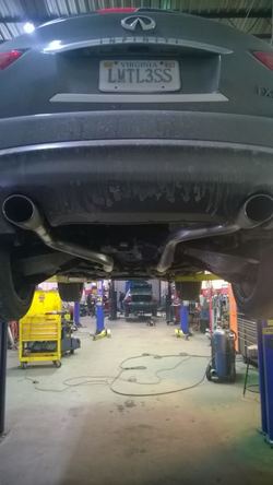

Alright guys here's some pictures and videos. The first vid is stock cold start. Then the picture of the work with the pipes in place (I know they don't look the same but he made the bends on the passenger side because of a sensor or something that was there.) Then it's the muffler delete cold start, and the muffler delete in cabin, where if you listen closely, you can hear the vibration. The volume of the muffler delete is getting quieter over time, it was horribly loud in the beginning, but I guess I'm getting a little used it. Still putting in the borla though because I just want a nice aggressive throaty tone without it being loud as shit.
My phone tones down the bass some in these videos.. just as a forewarning.
I'm planning to sell my factory set up, the way it is. So if anyone is interested in doing the muffler delete but don't wanna mess with the stock set up, this will work. I'll post up an official marketplace post if people show enough interest and figure out a way to get it out. I would prefer some one in VA so that they can come pick it up, but if I need to ship it, I will. Enjoy!

10hp gain is really only after a proper tune, and even then that's at the crank (I know, depressing - right) It'll actually mess with your low end a bit being a "true dual" exhaust setup with 2.5" piping as opposed to the factory 2.25" w/ Ypipe to dual exit.
Either way, it'll sound better.more aggro than stock, but not as ridiculous as the muffler delete.
Will I feel the mess up at the lower end? What does that mean in layman's terms?
It's an age-old argument regarding back pressure in the exhaust system... the less restrictive is usually thought to create the most power and be loudest. Although this is arguably true, if there is no restriction on the motor the low-end torque "feel" lessens because it's easier for the motor to push the air through the piping. So, you'll have more HP and maybe even more tq, but it will be at much higher RPMs and you will "lose" some low end "power"
In layman's terms, it'll feel a bit more sluggish off the line, but nothing too bad since you went to 2.5"... if you did 3"+ then you would feel it more.
People will argue these things back and forth no matter the motor make or model but I've experienced this with my old FX from going through a few different setups.
