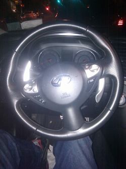

Dont know if you guys remember or read my first post but, i was hearing a rubbing nosie and feeling vibration when turning my wheel at slow speeds ...took the car to the dealer and they said the transfer case was bad and they replaced it.....the problem seems to be gone but now it seems like i need alignment. am not sure what is removed and or taken off to change the transfer case ...but can someone confirm that after replacing it would they need to do an alignment and did anybody else have this problem.?
This is how my it looks when my wheels are straight

I would take it back to the dealer and have them correct it. If it wasn't like that when you took the FX to them than they should fix it.

As for the steering being off center have them look this technical service bulletin up:
ITB08046
  • SERVICE INFORMATION If a customers reports their "vehicle pulls" or the "steering wheel is off-center" use the Diagnostic Flow Chart and other information in this bulletin to diagnose and correct the issue. See this bulletin for further detail.
I saw it a while back but didnt think anything of it because it said ..35 only ....did you need an alignment after.
ITB08046

Dealer should fix this alignment thing for free under warranty. If it wasn't like that before they gave you the car make them fix it no questions asked!
