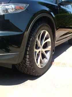

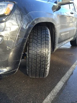

Alright guys, I need to know if 20x10.5 wheel will fit in the front of the FX50? I've already read about other members runnings 22x10.5. I'm planning on running Blizzak v2 at 285/50/20 which I'm aware is a 31" tire. Another member is running that tire size on his First gen with no rubbing issues. I can't seem to find offset for the wheels Giovanna Haleb. I'm gonna try to email some vendors and see what I can find. Thanks guys

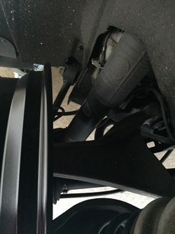

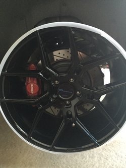

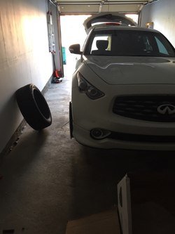

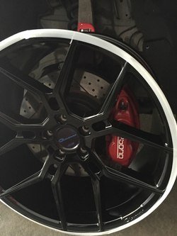

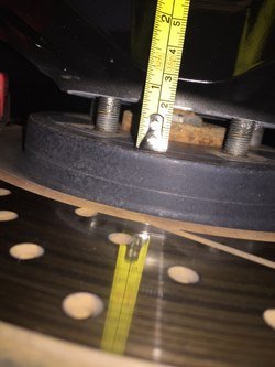

Ok so I'm in the same boat as you, looks like I'm going to have to run a 15-20mm front spacer. Do you think that's too excessive and wide? I'm trying to avoid any full turning issues, overall this struggle is fun tho. 6301b94a5de1e12e3b9f8511f761b409.jpg54ef45a61630d6a8b3433a445dcb1a9d.jpg123e5d5396bacfe0afa6298fb06cf23f.jpgacb5a81a3b885471bb6e0d6966fcb3c7.jpge5cd79054e2c93d021cba1b87a0f4db3.jpg Here's some pics of fitment, I've lined it up so the caliper and spindle are clearing. The rear seems to be fine. I'm just contemplating wether or not to get 9" up front or just use a 20mm spacer. Spacer is my cheaper route as I wouldn't have to pay a restock fee ect on the exchange. I'm attaching medium photos, greatly Appreciate your feedback thanks!

If the offset is +45 then a 20mm spacer should be fine unless you are slammed. I had to run a 5mm spacer with +35 wheels to get clearance initially.
Right now I run +5 offset in front with a 10.5" wheel which is about an inch past where you will be. But that required some work and camber. If you're stock height or slightly lowered I don't think an effective offset of +25 (with spacer) is going to cause issues. There won't be any problems with full lock, even I can do that without rubbing. Your tire may poke out a little bit, but hard to tell based on your picture since the wheel will camber in once it's on the ground.
