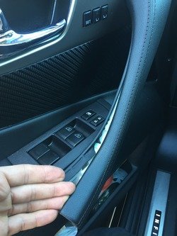

My 2009 also has a driver side door rattle caused by low notes from the stereo. I've isolated it to near the arm rest because if I press down lightly with my elbow on the arm rest the rattling stops. Thanks for the document. I may try this some weekend.
Its the handle you pull to close the door. If you feel around the edges you can actually pull it off with your nails or a plastic prying tool. Theres tabs that break when you pop this handle off & rattle afterwards. If you remove the two screws in the handle & pop the door panel off theres a bunch of clips that hold the door panel against the door. These clips have a lil round insulator on them that usually falls off when popping the panel off they look like round gaskets. If your missing at least 1 it will rattle. You could make some out of some felt material and add them to your panels clips & the rattle should go away. Worked for me. Good luck!
