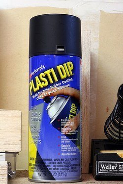

And here is how Plasti-Dip looks for anyone interested:
